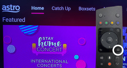

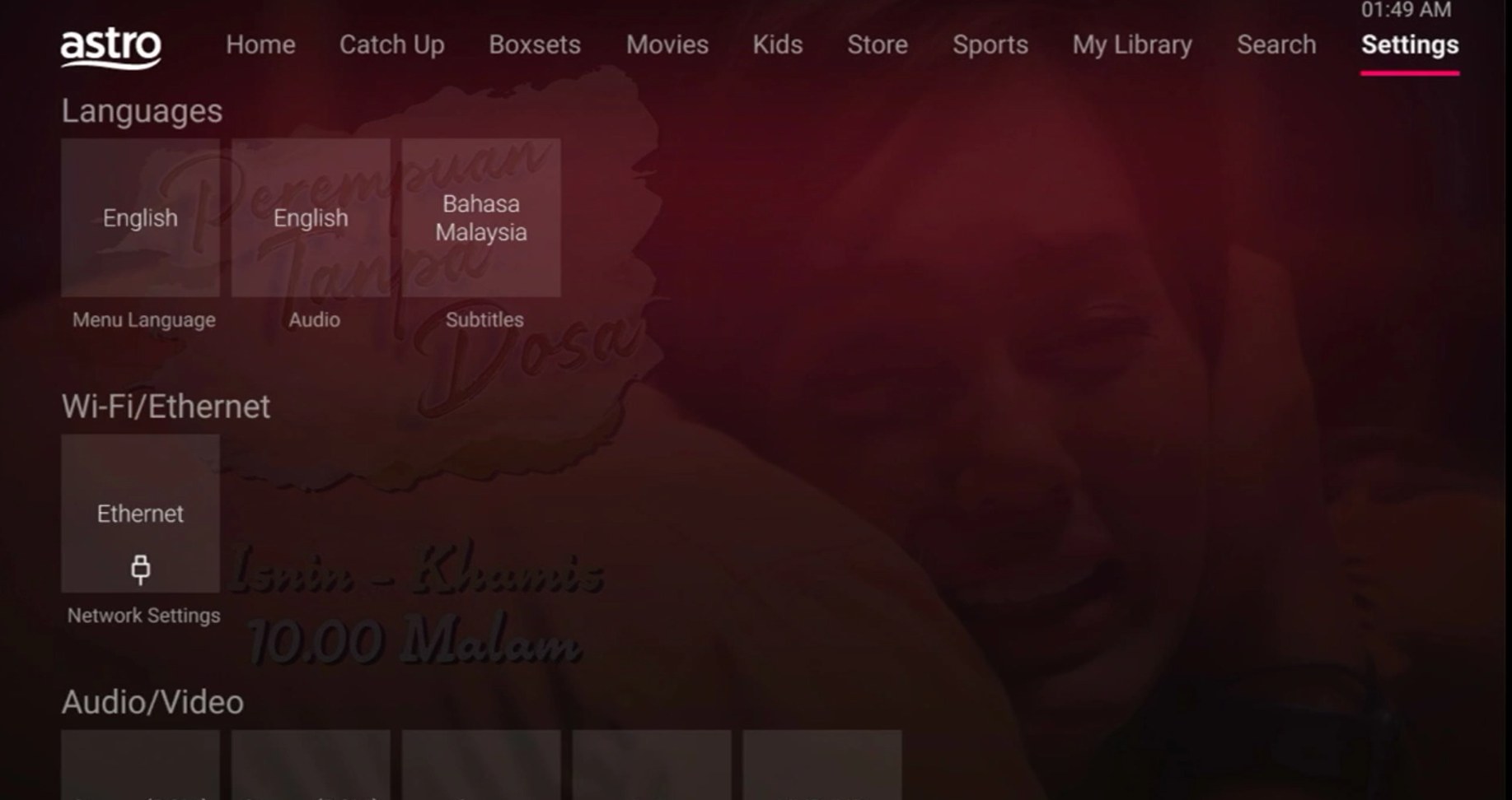

On your remote, press the HOME button and the home menu will be displayed on top of your screen.

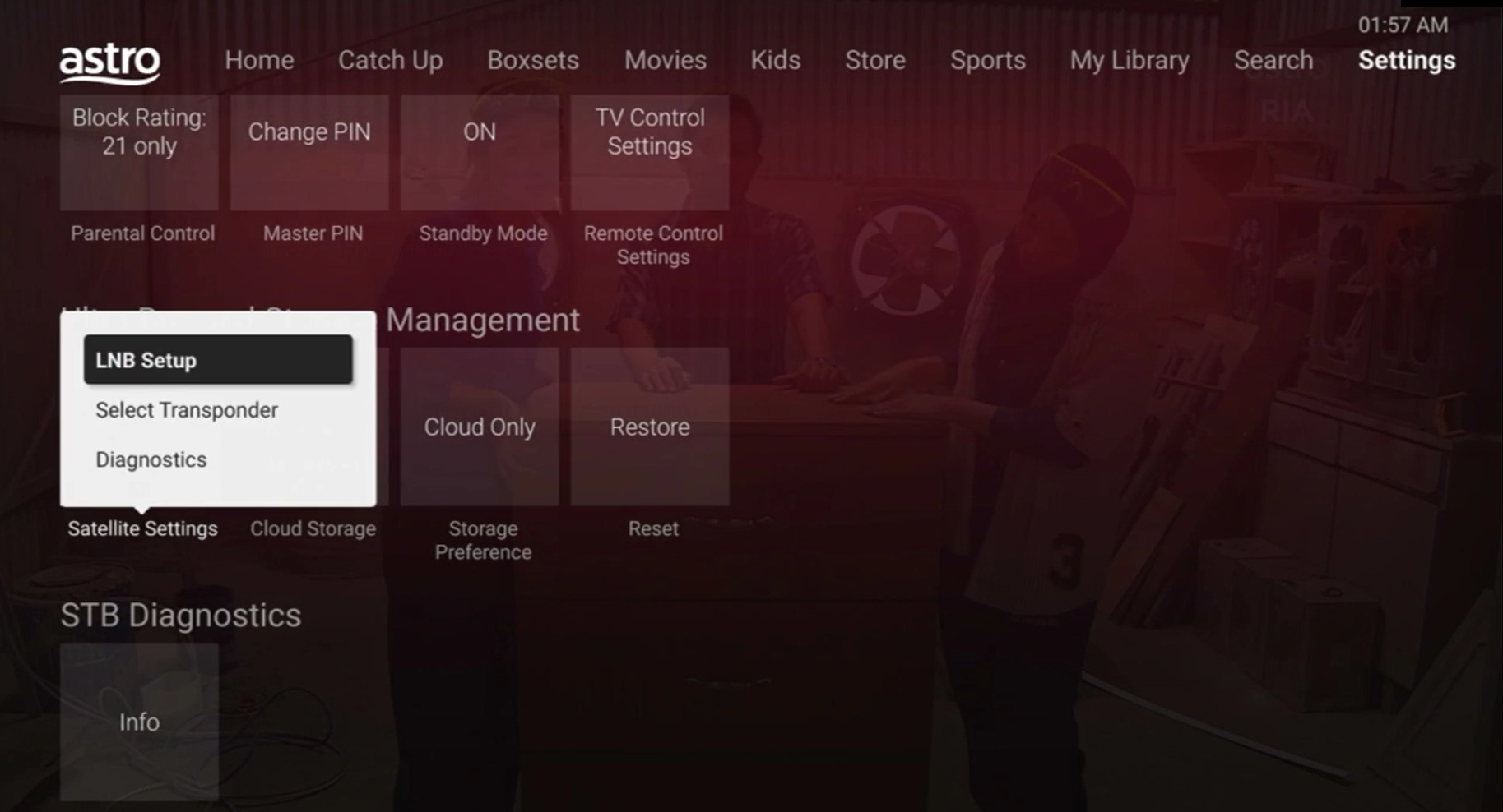

Navigate to Settings.

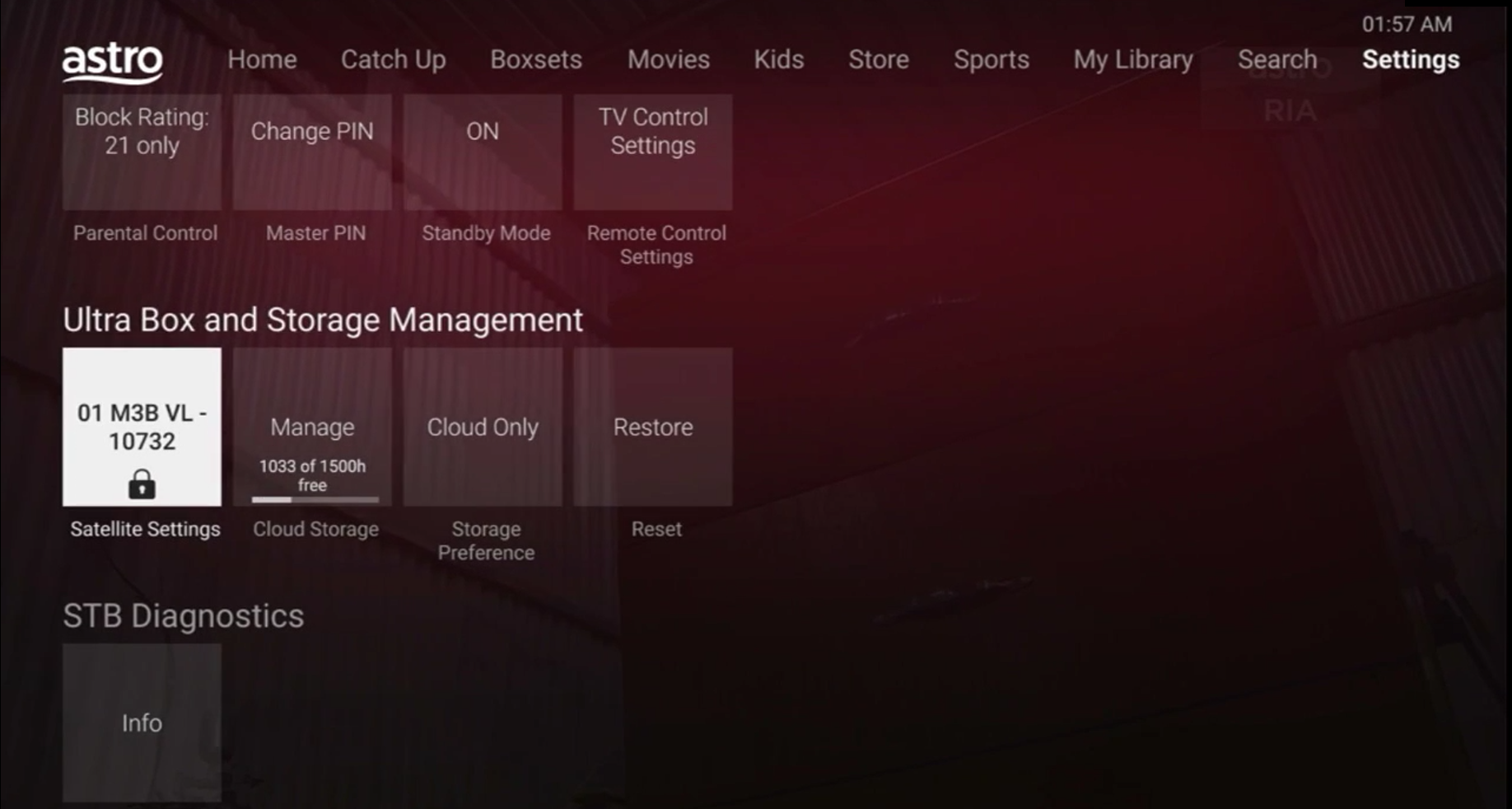

Navigate to Satellite Settings and press “OK”.
Navigate to LNB Setup and press “OK”.

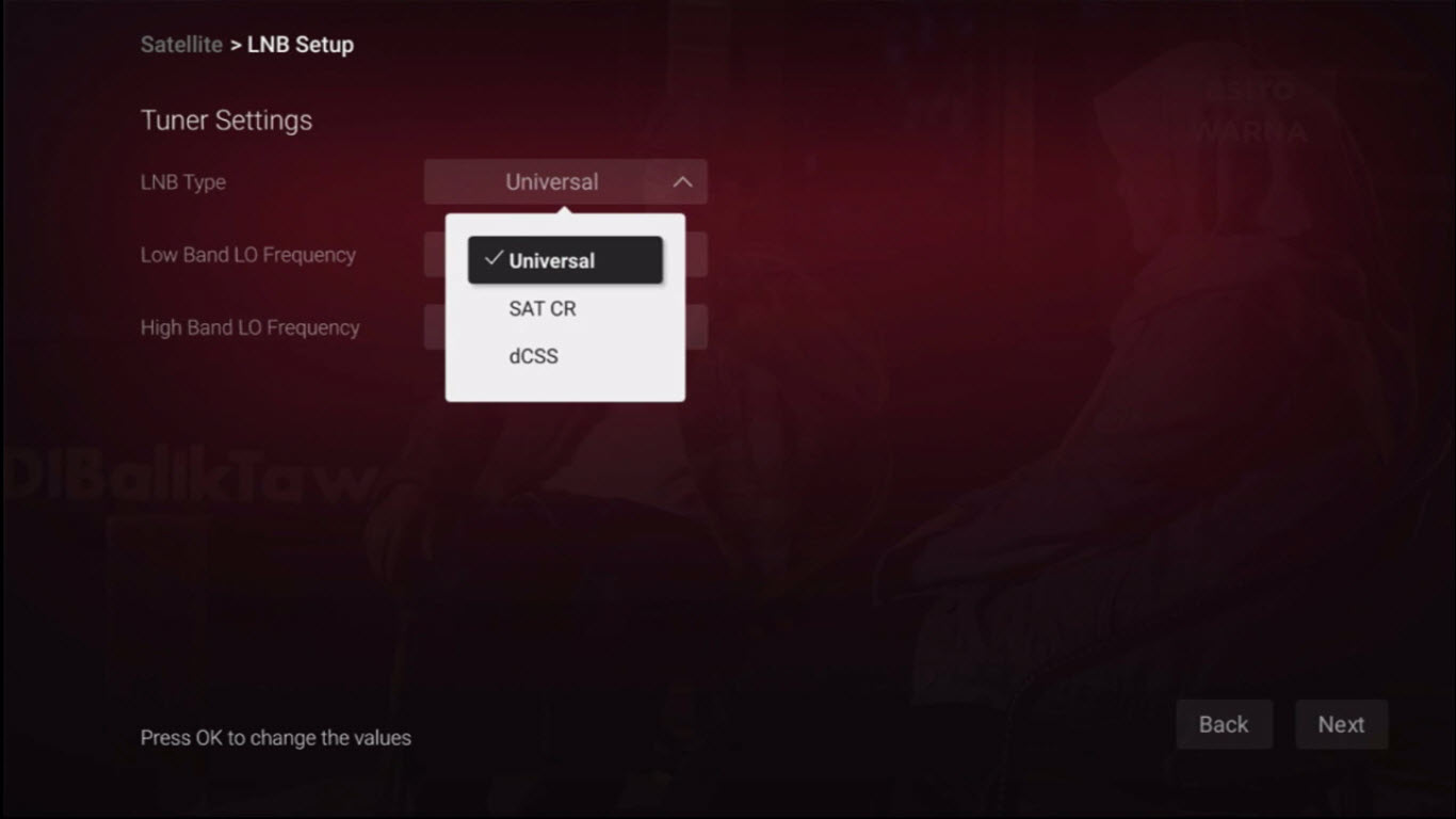

STEP 6

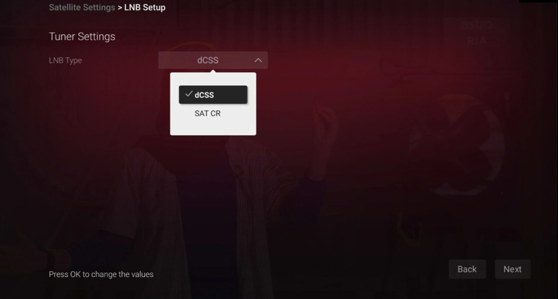

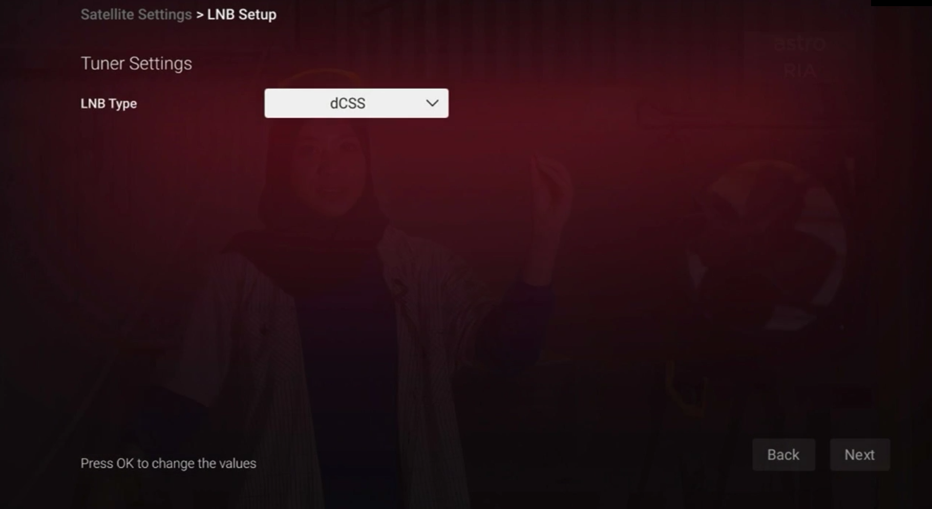

Select LNB Type connected to your box.
Ultra Box available selection
Ulti Box available selection

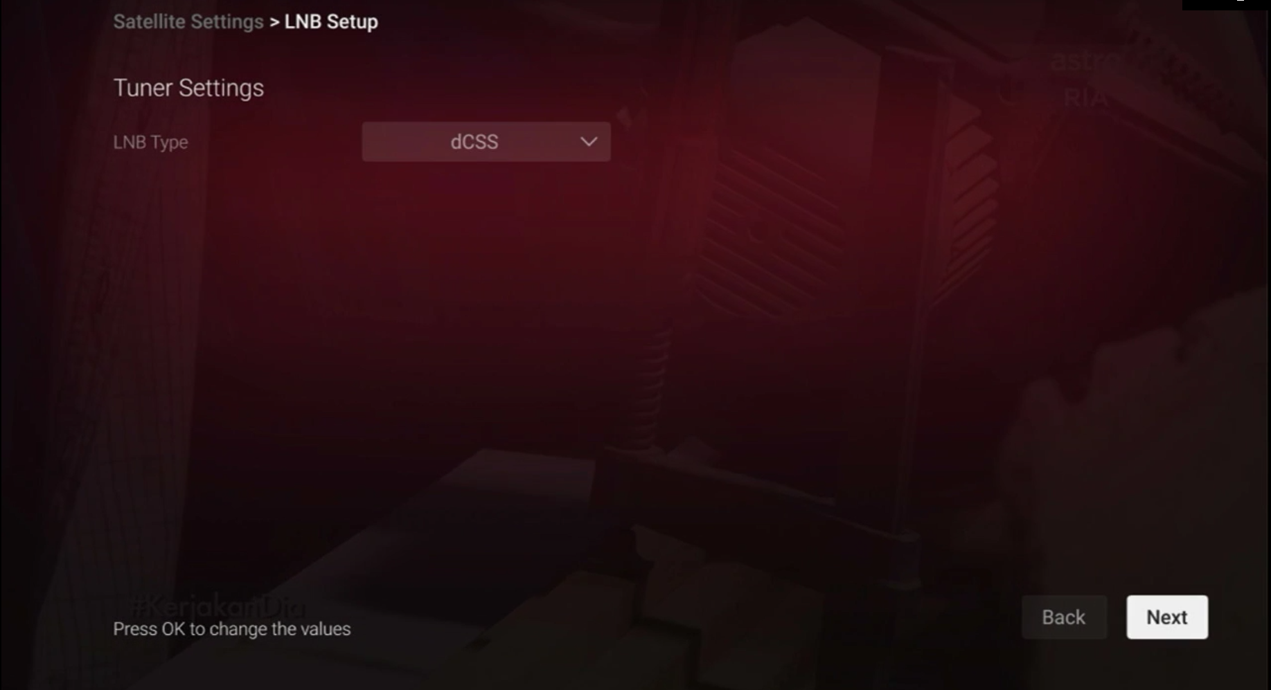

STEP 7
Navigate to Next and press "OK" to confirm your selection.

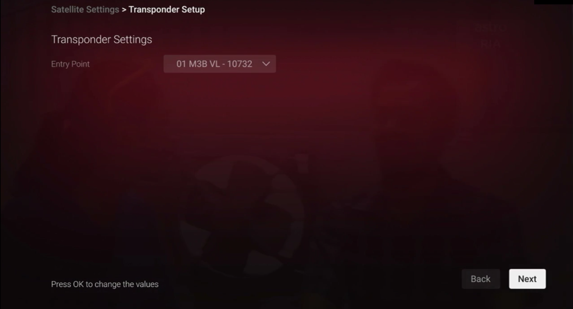

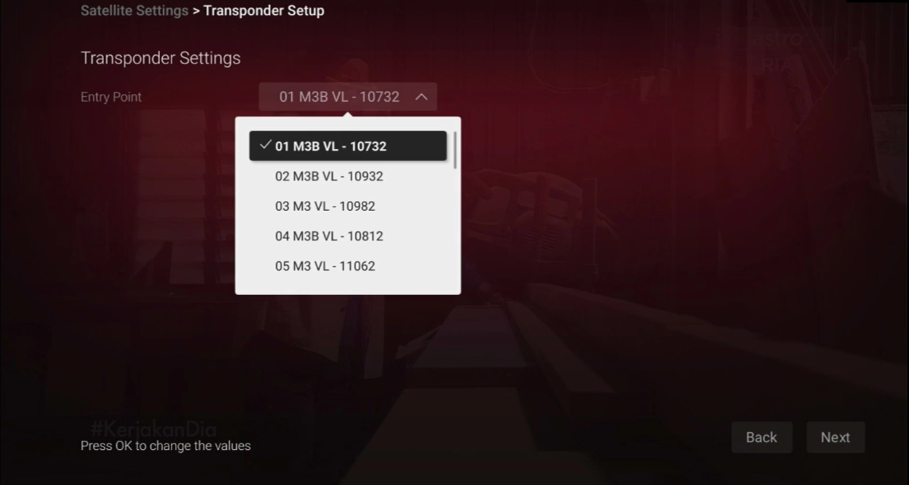

STEP 8
Select this as the Entry Point and press "OK" to confirm your selection.
STEP 9

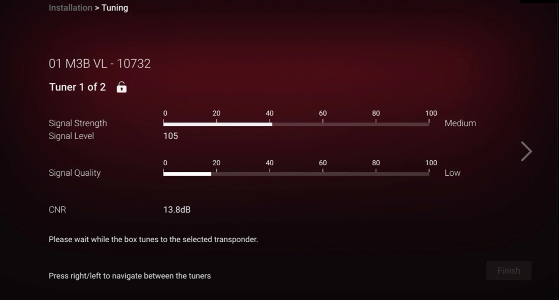

STEP 10
Signal reading results for Tuner 1 screen will be displayed accordingly.
Press right to navigate to Tuner 2.

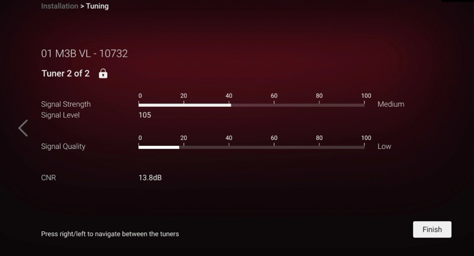

STEP 11
Signal reading results screen for Tuner 2 will be displayed.
Then navigate to Finish and press "OK" to complete the setup.
