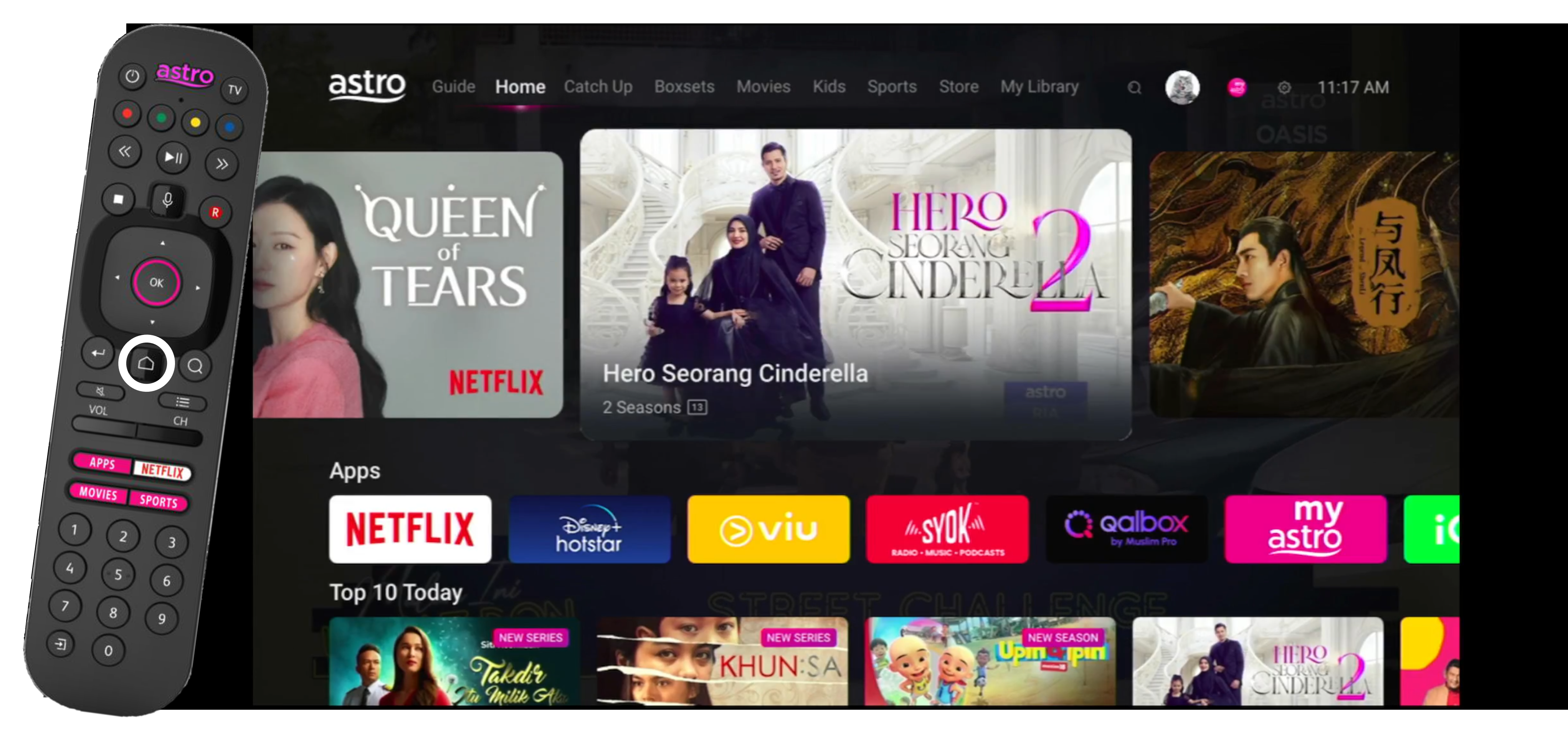

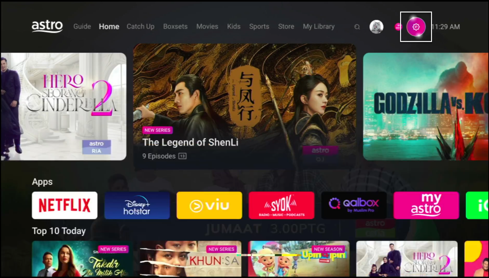

On your remote, press the HOME button and the home menu will be displayed on top of your screen.

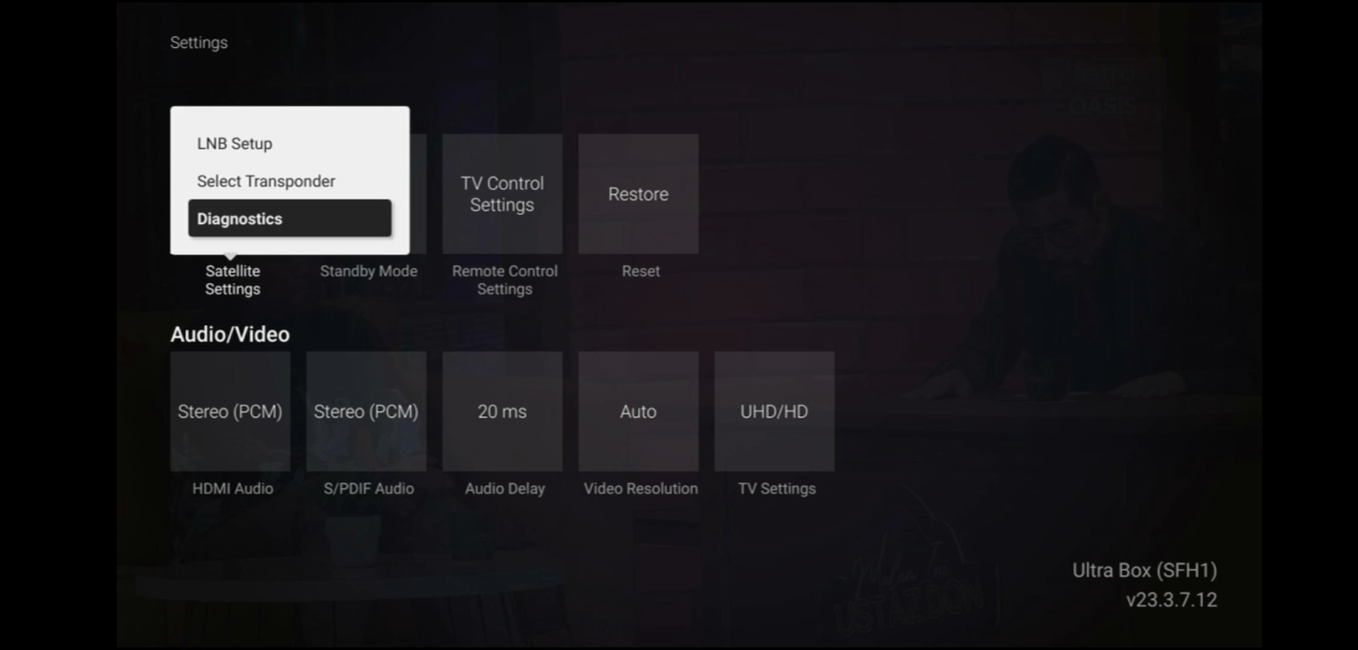

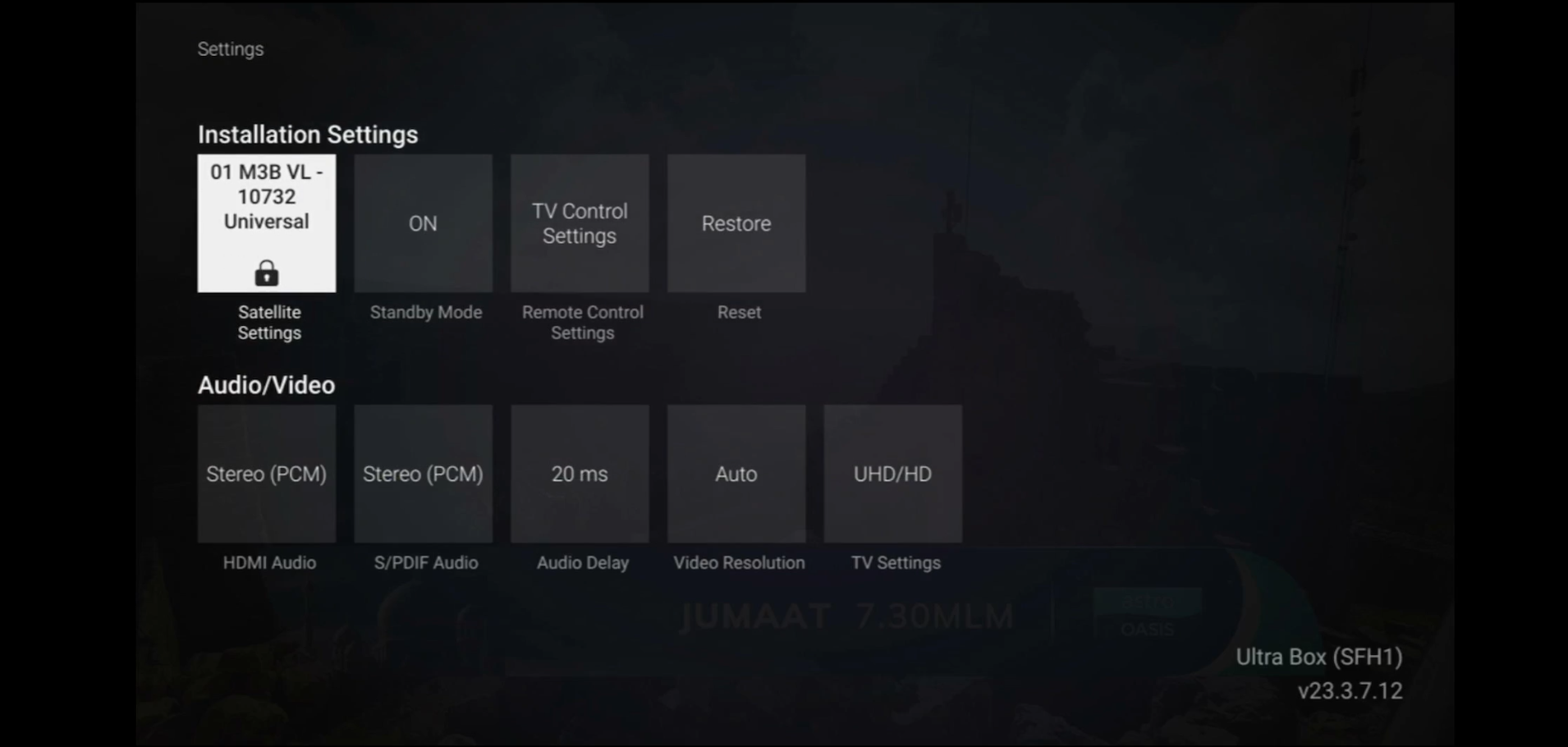

Navigate to SETTINGS.
Navigate to Satellite Settings and press “OK”.
Navigate to Diagnostics and press “OK”.

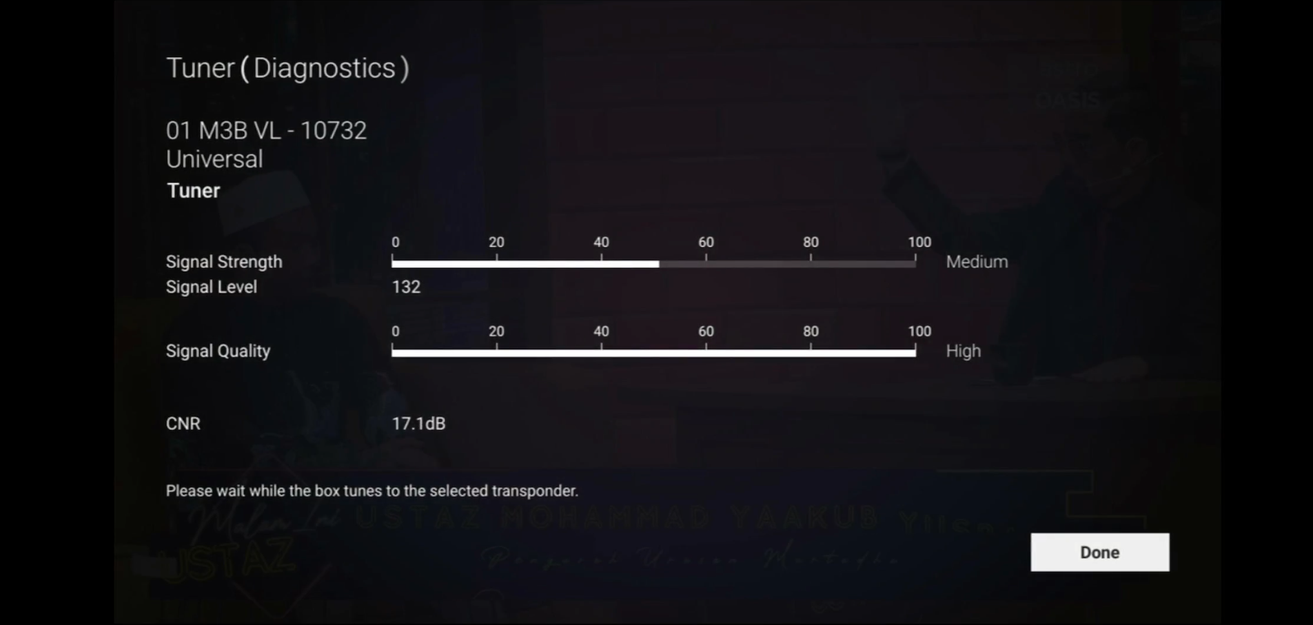

Refer to the signal strength on your screen.
If it is 65 or higher, please take the screenshot and submit your feedback form.
If it is below 65, please go to Step 6.

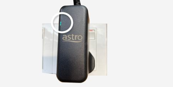

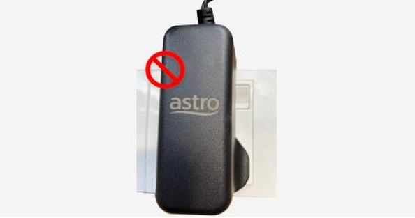

Switch off the power for your box and make sure that the adapter’s power light is off.

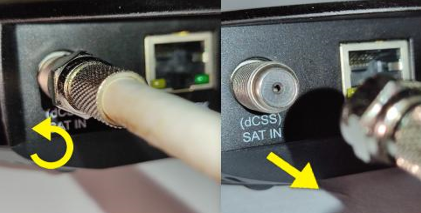

Unscrew the satellite cable from the box and pull it out.

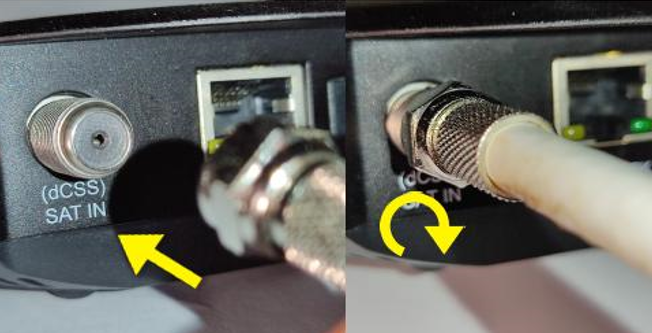

Plug the satellite cable back into the box and screw it back securely.

Switch on the power for your box and make sure that the adapter’s power light is on. Please wait for 5 minutes.

If issue persist, please submit the issue on our Feedback Form with error details and attach a picture of your General tab of the STB Diagnostics for assistance.
